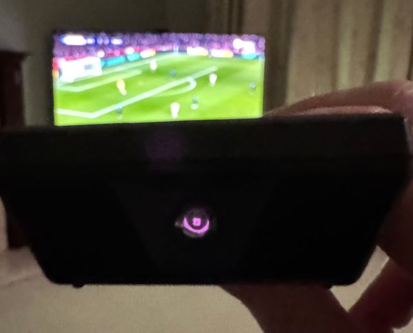

As a quick check to see if the remote is trying to send a signal, point the remote into a mobile phone camera, you should be able to see the signal.

Any signal showing with the mobile phone camera? Perhaps you have got a “eBay” remote.

Sorry, I missed bit about pointing remote at phone camera. How do I do that exactly? In your image, camera screen looks dark.

Hi @SteveStacey   Simply point your remote towards your camera lens and press a button. That large black thing is the remote end that normally points towards the TV. The light showing is the infra red signal that becomes visible on a mobile camera. My IR remote is a different shape to yours (RMT-TX440E).

Thanks. I’m not normally a technophobe but struggling with this. Am I meant to be pointing remote at the lenses on rear of iPhone 11 camera? If so, can’t see any signal being projected. However, difficult to know if I’ve aligned it correctly.

Hi @SteveStacey   Yes, using the lens on the back of your iPhone, make sure that it is the end of the remote that normally points towards the TV and far enough away to show the entire end. If you don't see a light (IR) when you press a button, that means the remote is definitely not working (dud). No need to take an image, I did to show you what an IR signal looks like (iPhone 15 Pro rear camera, not the one that you use for selfies!).

“Far enough away to show the entire end”. Can you explain this please. Thanks.
