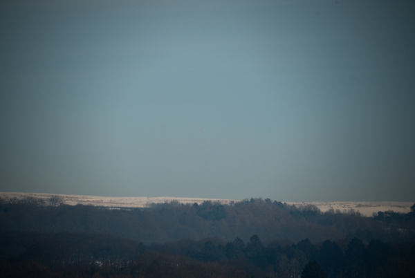

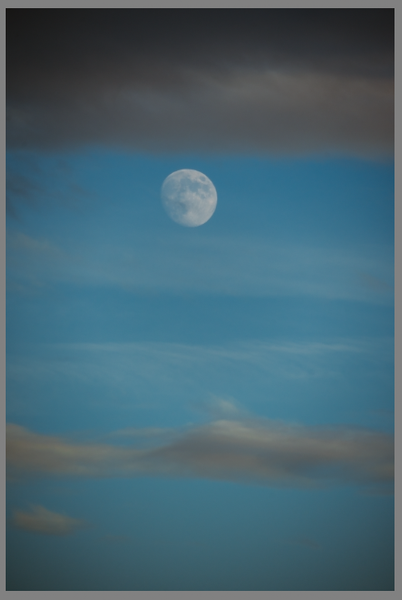

Hi Sony Community,
I'm trying to understand something that started happening recently using my Sony A7IV + 100-400GM lens which I have used for the last 2  1/2 years. After a cold day in the snow recently, I have noticed a shadow in the centre of my photos and I don't see any solution online as to why this is happening. I can live with the usual vignette but this circle in the middle is bothering me a lot.
I have attached the same photo (one over dehaze to accentuate the circle so it's very evident, and the others is for you to see that even with normal editing I can still see the circle (especially in the small thumbnail down in Lightroom Classic) I have tried removing the neutral filter from the lens, shooting settings, but it seems to be always there (at 400mm is more evident)
Any one with the same issue??
 Screenshot 2025-01-11 163103.pngScreenshot 2025-01-12 114943.pngScreenshot 2025-01-12 115006.pngScreenshot 2025-01-12 115019.png
